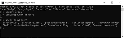

  • I open a subprocess via a toolbox script of ArcGIS Pro and check arcpy.env in the new subprocess.
    arcpy.env has only 9 attributes - why?
    >>> arcpy.env.keys()
    ['scratchGDB', 'scratchFolder', 'packageWorkspace', 'scriptWorkspace', 'addOutputsToMap', 'buildStatsAndRATForTempRaster', 'autoCancelling', 'isCancelled', 'overwriteOutput']
    get and set the other attributes causes an exception
    >>> arcpy.env.compression
    File "<stdin>", line 1, in <module>
    AttributeError: 'GPEnvironment' object has no attribute 'compression'
    >>> arcpy.env.compression = 'PackBits'

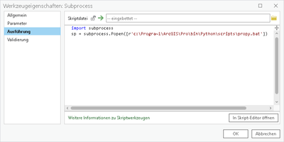

I created a simple tool (without parameters).
Running the tool will launch the Python console, just like above from the ArcGIS Pro Python window.
In the Python console I check arcpy.env
