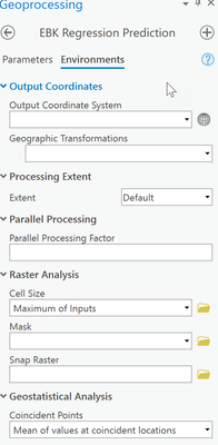

wizards are nice, but they don't reveal all the optional parameters.
Use the GA toolset in Arctoolbox for your desired tool, there is an Environments tab for each tool where you can set parameters like the analysis/processing extent.
