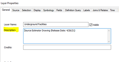

BenjaminBlackshear
Update to this, ArcMap has a description section when you view a layers properties, but Pro does not for some reason. I was able to set descriptions for my layers in ArcMap, and then import the MXD into pro and the descriptions persist when exporting a KMZ from this. However there is no way to view of edit this description in Pro which is not ideal. ESRI, please provide access to the layer description in Pro that is available in ArcMap.

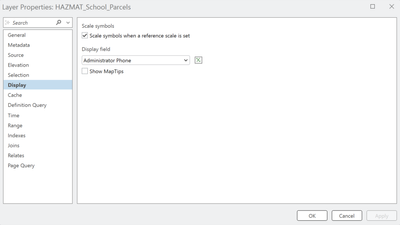

tbrink_DOIT
In case anybody is wondering, it's in the layer properties, "Display Field".  You can only choose one.
CPaulman
Hi tbrink_DOIT,
What you are describing is the Category for the individual records in the layer. (For example you can choose display to LAST_Name and you will see a bunch of last names when you expand the data.)
