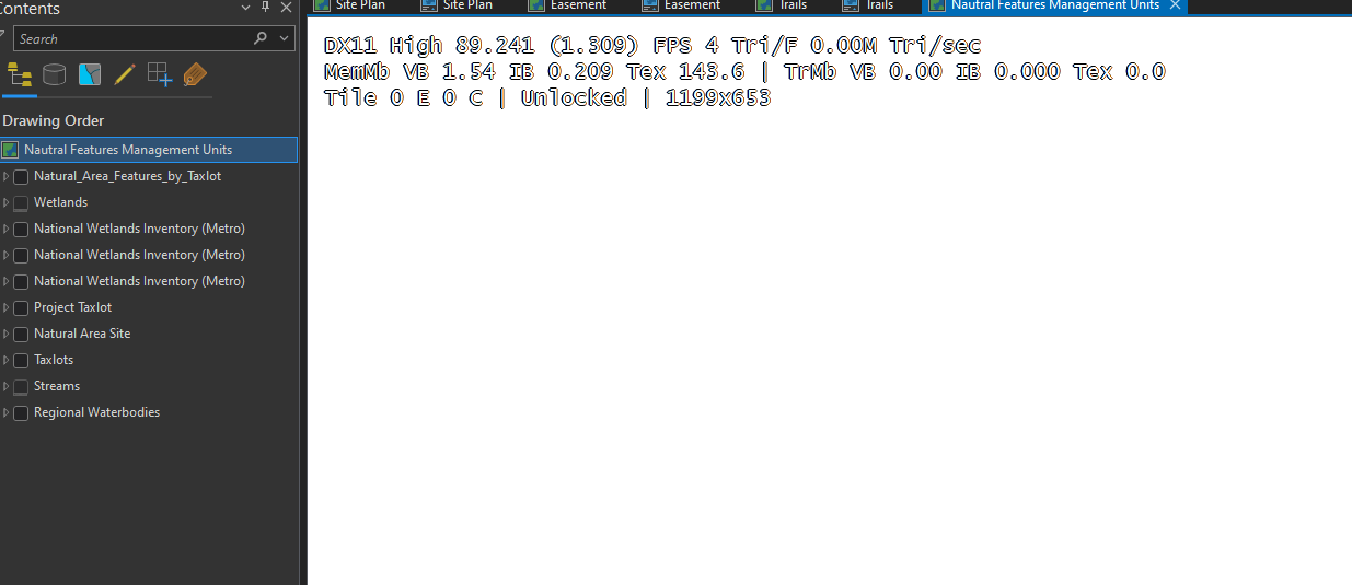

I must have hit a shortcut key in ArcGIS Pro while I was updating an attribute table. It enabled what appears to be imagery tile info at the upper right corner of my layout. I have no idea how to turn it off or remove it. I've remove all my aerial imagery from the layout, and the text still appears. Does anyone have suggestions on how to turn this off or remove this from the layout?

@La_Olivia - to disable this item, you can go to your Help core tab and in the Customize group, click Shortcuts.  This will open the Keyboard Shortcuts pane.  Expand Global and you'll see that, likely, your Drawing Performance Overlay item is checked on.  It was checked off for my ArcGIS Pro installation.  You can either uncheck to disable this item or use the shortcut key, Shift+E, to display or not display the information seen on your screen grab.
You can learn more about what the readouts mean here.
