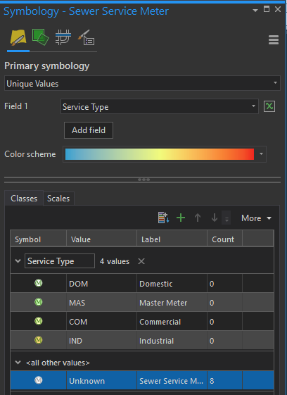

I have several layers symbolized with a Field, and then there's <all other values>. In the legend, extra room is being added between the symbology class based on the field and the <all other values> class. How do I make the spacing the same for all symbols?
How my symbology is setup:
 Symbology - classes based on field and all other values

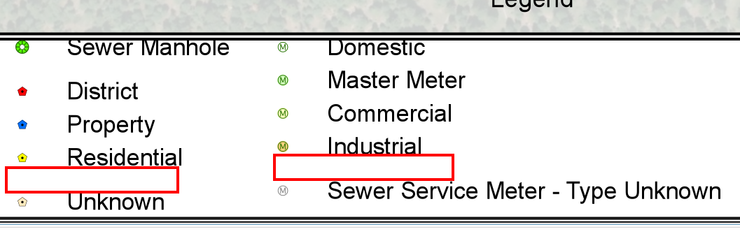

There is extra space between the Service Types and the <all other values> and this is repeated with any symbology like this.
image showing legend with box around empty space between classes

Interesting.  One thing you try is to remove <all other values> using the More dropdown button just to the upper right from the COUNT.  Then click the Green Plus Sign to add UNKNOWN as a value in the Legend List vs. using <all other values>.  Would that resolve the space issue?

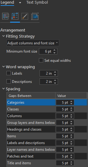

Try adjusting the "Categories" spacing in the legend properties.
legend spacing in ArcGIS Pro
ShylaBlack
I just had this issue so I followed the instructions above to adjust the categories, but its actually fixed by adjusting the Items.
