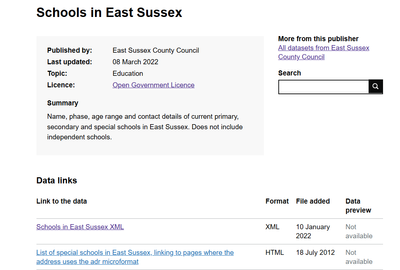

Hi,
I'm building a map of facilities in Eastbourne and have found some open data from Data.gov.uk with the locations of schools from East Sussex County Council. I'd like to import this to my map, but the only format available is XML and I can't find a way to get this into ArcGIS Pro. Can anyone help me please? There are other datasets in this format too so I need to work out a solution!
Thank you
This is a screenshot of the webpage. Address is
Schools in East Sussex -https://www.data.gov.uk/dataset/e20e6581-1da4-46bb-94e8-bab86cd0e165/east-su...
