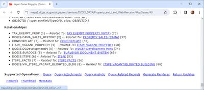

For example, this layer has several related tables.
This is the code to loop through the related records from the related table "DCGIS.SURDOCS" for the feature.
var related = FeatureSetByRelationshipName($feature, "DCGIS.SURDOCS");
