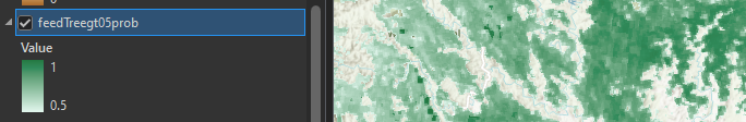

I have this layer called 'feedTreegt05prob' in Arcpro and I am trying to extract it so I can add it to an AGOL map that will be used for viewing in a storymap.

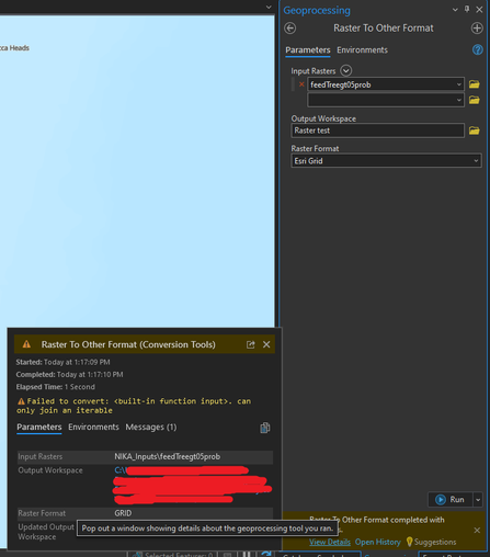

I have also tried Raster to other format, and other geoprocessing tools, but again I get errors.

In the end I need the layer, as shown in arcpro, to be visually the same in AGOL map (as seen below).
