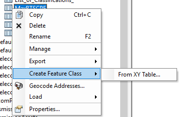

Ok, that way is creating and Event Layer.
Right click on it in Catalog and Create Feature Class from XY Table.  However, can you select the points you created?  If so you should be able to copy and paste them into a different layer

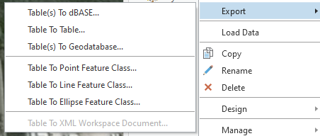

Ok I also did it this way:
And selected Table To Point Feature Class
However I cannot edit the feature class when I include it in my database. And that's what I want to do. When the layer is in my local file geodatabase I can edit but the issue happens when I put the data in my enterprise database.
