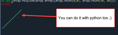

DanPatterson
MVP Esteemed Contributor
You just have to display it elsewhere 😉

JaniceBaird
@DanPatterson I am not sure I understand... I can draw a graphic line with python in arcgis pro as long as I don't want to display it in a graphics layer? Not following.
I have my script working by using a feature class. The feature class gets written over every time I run the script. It is doing exactly what I want except that it is not using graphics and a graphics layer. I was tasked with writing a script that would add graphics to the map view in pro. I will report back that it can not be done at 2.7.
Anyone know when this will be available in ArcGIS Pro?
