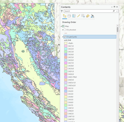

JohnBobbitt
Thanks Bob. But I can't edit the ArcGIS Pro map (below) produced from the file from that URL.
I need to edit each geologic unit: change color, pattern, name/label; make group layers; and change drawing order, as shown:

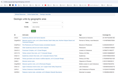

The editable shapefiles for each geologic unit are available at the URL below, but it takes 3 more clicks to get to the download page to get a single shapefile. I need to download all the files shown below, there are dozens for each state.
There has to be a way. Thanks again,

BobBooth1
John,
Not sure which map you're referring to or how you produced it.
What I would suggest is:
1. Download the state zipped shapefile + CSVs from the page I linked to.
2. Extract the zipfile to a local folder.
3. Open a brand new ArcGIS Pro project.
4. Make a folder connection to the folder where you extracted the shapefile and CSVs.
5. Add the shapefile and CSVs to your map in ArcGIS Pro.
6.  Right-click the polygon layer, click Joins and Relates, Add Join.
7. Join the units CSV to the polygons on the UNIT_LINK/unit_link field.
8. Symbolize the layer using unique values.
9. Edit the symbology however you like.
Yes, the data is all in one layer.
If it is a requirement for you that the data be split into multiple layers, by unit, you could use Split by Attribute to split it out into a bunch of different feature classes and add them to the map.
https://pro.arcgis.com/en/pro-app/latest/tool-reference/analysis/split-by-attributes.htm

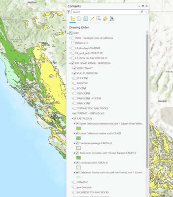

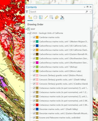

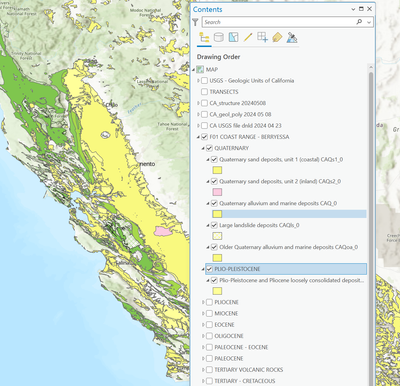

JohnBobbitt
Thanks again;
The map produced using your method produces the following map (thanks! I'm a novice). Note that I can't edit the label, drawing order, &tc., or group the units. I can change the color.
The map I was referring to (below) I produced by downloading the individual .zip files (3 levels deep) for each unit, extracting those files (to 5 files including .shp file), and using "ADD DATA" to navigate to the .shp file. This is what I want to automate, starting with multiple downloads from the USGS.
This gives me the ability to sort and group units by age or lithology, &tc., to edit the color and pattern, to turn select units and groups on or off, and to copy the units and load in other maps.
