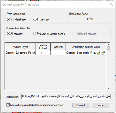

I've attached a screenshot of the window showing the issue.

We do have an enhancement request for the functionality you mention.
Add an additional option to Convert Labels to Annotation that allows annotation to be created in just one feature class. Label classes would be merged based on name, scale, and text symbol. Feature-linked annotation would not be allowed in this case.
The reason that you're seeing the annotation classes collapse into one class is that they are named the same and have the same properties.
in the example below the annotation classes were appended together but the text symbols were different as their colours were pulled from the symbols.  so in that case the classes were appended individually.
in this next case, the text symbols and scale ranes of the annotation are the same and the names of the annotation classes are the same.  so the annotation classes have been combined - except for the Circle 5 class as it does not have a corresponding class.
