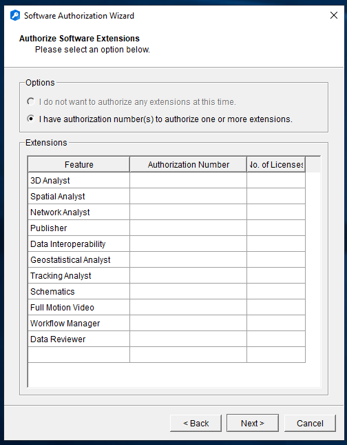

I need to authorize the ArcGIS Pro Image Analyst Extension in our License manager. Image Analyst is not on the feature list. Does it go into one of the others?SoftwareAuth.PNG
mody_buchbinder
Hi
Just write in the empty line below Data reviewer "Image analyst" and give your EFL number.
The Feature column is not important, it should understand by the EFL registration number you give.
Have fun

It's ArcGIS License Manager 2022.1

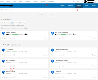

I am wondering if you need to enable Image Analyst from the ArcGIS Online organizational license management screen, instead of license manager. In my AGOL screen, I have an option of toggling on Image Analyst:

Thank you for your reply. This license is to be used as a concurrent license and not a named license, so it needs to be applied to the License manager. Unfortunately, there is no option on the extension feature list to choose Image Analyst. I was wondering if it can be licensed under one of the other features.

mody_buchbinder
Hi
Have fun
LindseyDagnall
Wow. Simplicity works again. Thank you mody_buchbinder!!!
