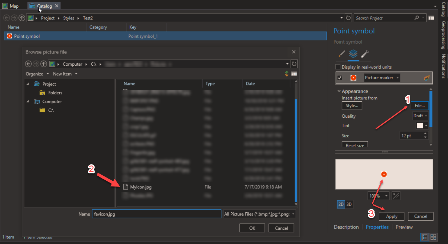

Jamil - once you create the *.stylx file as described by Dan, then you have to create a Marker Symbol Layer referenced here.
by Anonymous User
Not applicable
To add to Robert's reply as I was just doing this exact thing, here is a screenshot of how this looks in Pro for reference. This is after you have created a new Style in Catalog and added a new style class item. In this case my new style class item is "Point symbol" and it was a jpg called MyIcon.jpg.Picture Marker Symbol from file
