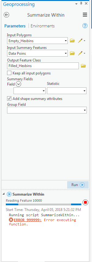

Hello,
I've been trying to use the Summarize Within script to calculate the number of points within a given number a shapes created using Generate Tessellation. Whenever I run Summarize within it gives me error 999999 (see picture below). I have been following the steps laid out in this article from learn.arcgis.com (Create supplementary charts and maps—Cartographic Creations in ArcGIS Pro | ArcGIS ). I was able to follow the article step by step and use Summarize Within with no problem. When I went to try this again using my own data in a fresh new project it didn't work. Currently my own data is in GCS WGS 1984. I have attempted to reduce my own data down to 1000 data points but its returns the same error. I have also tried to reduce the number of extra fields (fields that arn't lat/lon) to no success. I have the most up to date version of ArcGIS Pro and the error still occurs after I have rebooted. Below is step by step process I was using to get this error:
-Add data to project using add data (data is in .csv format)
-Use XY Table To Point to create a feature class containing the information from the csv file. (coordinate system GCS_WGS_1984)

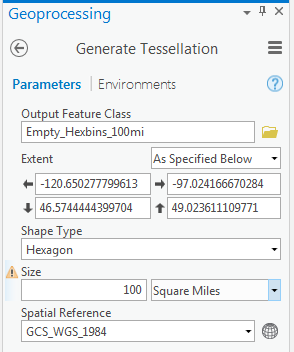

-Use Generate Tessellation to create a set of bins over the extent of the feature class created in the last step.(Picture below)
-Use Summarize Within to measure the number of data points in each bin.(Picture below)
Please let me know if any of you have experienced this error before and know how to get around it.

What is the warning beside your chosen units?
BenKawecki
All of the points are in the right spot. I have used this data set before, the full data set is roughly 1,000,000 points with lat/lon/alt.
The hexbin, data set, and output feature class are in the same geodatabase.
The warning is "converting areal units squaremiles to squareunkown no supported."

BenKawecki
Sorry, I didn't clarify that enough. I have used this data set before but not with summarize within. I have halved the data set and even taken 1/100th of the data set. It still gives the same error. When I go back into the project I created to follow the learn.arcgis.com link Summarize Within Still works fine. I'm currently running all of this in pro. I think my next step is to create a new project and try to import that data set again. See if that will fix it.
