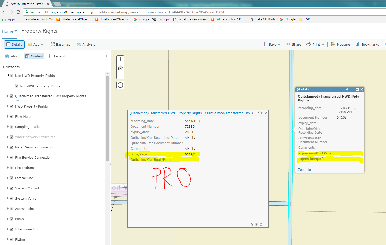

I read in Author a Webmap that "You can define pop-ups in ArcGIS Pro for all web feature layers so that when shared, the pop-ups are already configured." However, I configured a popup in Pro with two expressions (highlighted below) and neither the label nor the values are showing up correctly in the webmap.
Popup with expressions in Pro - how it appears in webmap

In addition to what Kory asks, can you post the expression that you are using? If ArcGIS Arcade | ArcGIS for Developers is used, it should be available in web map. Also please enter the pop up configuration of the web map and see if the expression is there (the field/expression name is there, but is the expression there too?).

I don't see an expression editor option in the webmap. But I opened the custom attribute display window and it doesn't reflect the custom attributes that I created in ArcPro.
