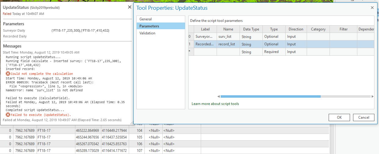

I'm trying to build a tool based on script in arcgis pro (the tool makes changes to a field with calculate field based on a list of variables). how do i use a list inserted with arcpy.GetParameterAsText() within a codeblock function in calculate field ?
my problem is that it does not recognize my list: "NameError: name 'surv_list' is not defined"

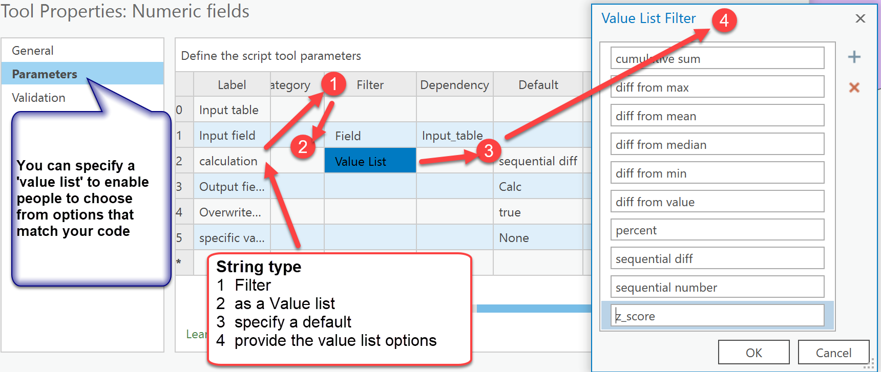

Use a custom python tool and attach it to a toolbox.  Get your parameters first then use them in the code block
Adding a script tool—Geoprocessing and Python | ArcGIS Desktop
Use your surv_list as a "value list" under the "filter" option.
Setting script tool parameters—Geoprocessing and Python | ArcGIS Desktop
It would be a Text parameter, direction "input"
The same for your other list.
The inputs can then be fed into your code block.

Thanks for replying. I did all the thing but didn't understand the "use of surv_list as a "value list" under the "filter" option". my attempt is to enter a random list to the tool in the form of:(name,from_point,to_point), or list of lists: ((name, from_point, to_point),(name2, from_point2, to_point2)) and than use these 3 variable of each list in the code block to return a value if i have a match.
i might have other problems with my code but for start, i cant get the list i enter in the tool to be identified in the code block. any suggestions ?

You enter the value list manually
