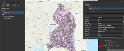

I looked at the file and it looks like there is a relationship class within the Feature Dataset. If you bring in the Property_Py polygons and select a parcel, you can get all the related information in the LDF table:
You may be able to select all the parcels needed, view the related tables and export the data needed.

George_Thompson
Esri Notable Contributor
When you select the parcel and the pop-up opens, you need to hit the "right triangle" button in the popup to expand the selection. It will show the related records in the LDF table.
Another option is select the polygons and open the LDF table and view the selected records.

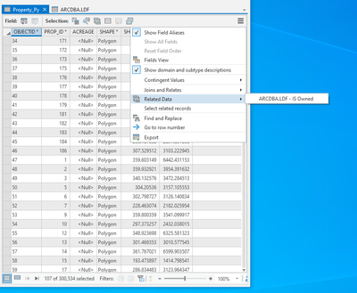

JustinJohnston
I figured out what I needed to do.  I opened the Property_Py polygon in ArcGIS Pro, then opened the attribute table for it.  It had the 5 or so attributes at that point.  I opened the ARCDBA.LDF file as well at that point.  Then I selected the Property_Py polygons I was interested in.  Then in the Property_Py attribute table, on the top right of the table, there are 3 lines for more options.  I opened that and, hoered over "Related Data" and clicked on the resulting ARCDBA.LDF table reference that appeared.  It then opened the ARCDBA.LDF attribute table with the data filtered to show the selected polygon information, which I could then Copy the selection and put it in Excel to work with it.
