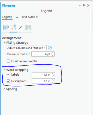

No matter what font size or fitting strategies I apply, I can't figure out how to allow the label text to remain in the same row -- it keeps splitting my labels into two rows, as if the legend width is super small. How can I allow my legend items to spread across the legend width?
AubriOtis
It sounds like you might have word wrapping turned on for your labels. If you change the word wrapping values to be larger or turn it off altogether your labels should take up more space.

Brenda_Thompson
ugh, word wrapping was the culprit! thank you so much
