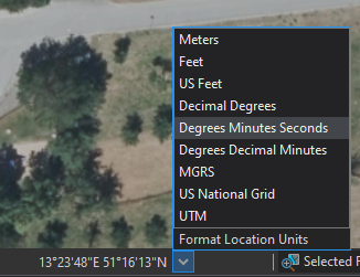

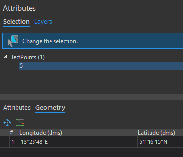

Option 1:
Select the point, switch the map's display coordinate system to DMS, get the coordinates from the geometry tab in the attribute pane:

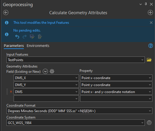

Option 2:
Calculate Geometry Attributes, this will store the coordinates in the feature class. The result is static, if you move the point, the calculated coordinates won't change until you repeat the process.
