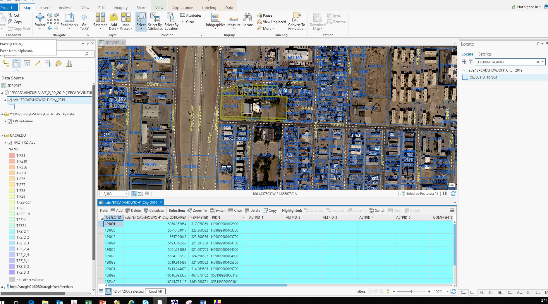

vincezubia
Victoria,
It seems like it wants export all parcels, but I just want the selected ones.

vincezubia
I exported the data with a tab on top table, then export. Output name project.csv and it worked.

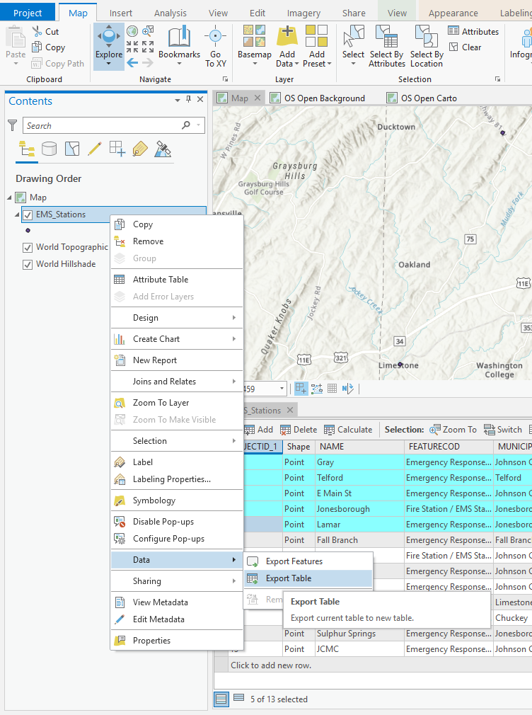

You can export attribute table information to a table by right clicking on the feature layer, going to "Data" and
choosing "Export Table".

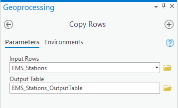

This will open the "Copy Rows" geoprocessing tool. Here, you can specify your output table.

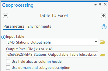

After you export these attributes to a table, you can use the "Table to Excel" tool to convert this to a .xls or .xlsx file.
