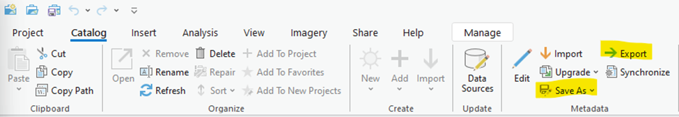

RECOMMENDED: In the Catalog pane, click on the feature class, raster layer, or other data type and find the “Catalog” ribbon with a “Metadata” group. There, you will see “Export” and “Save As”.
The Export dialog is really simple. I generally use ISO 19115-3 format. As described below, you need to know the format when you import it, so it helps to put this in the filename.
The other way to export is the “Save As” options. There is an option to save as HTML. This is good for end users to view it, but not for MD interchange. There is a Save As XML option, but I don’t understand how it’s different from Export, so I don’t use that.
Importing MD
To import MD, choose the “View Metadata” option for the data set in the Catalog pane. In the “Manage” context ribbon, use the “Import” button (to the left of the “Export” button in the screenshot above). I don’t know why you have to tell it the type when you import MD. It seems like this should be embedded in the XML file you’re importing, but I just choose the same format I exported as, assuming I created it.
