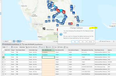

How do I disable the ' You are changing the subtype for this feature.' pop-up window on GIS Pro?

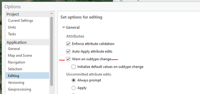

There's a setting for it. "Warn on subtype change". Check your editing tab of the application settings, I believe the checkbox is there, but I'm not at my ArcGIS Pro workstation to confirm.

JenniferCadkin
The 'Warn on subtype change' option is in the Options dialog, Editing tab under General

DianaAlvarez
thank you!!!!
