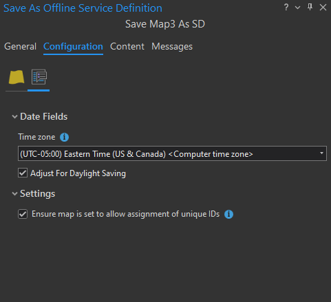

I don't see any publishing parameters in ArcGIS Pro for target SR, nor do I see any projection or transformation parameters when I try to save as a service definition file. Can someone point me in the right direction to make this happen?
I have tried with sharing just the layer and also with saving a new map with the layer all with the proper WGS84 GCS.
