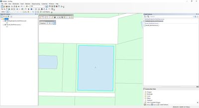

jlperkin
I was able to offset the buildable footprint from the property line 5 feet with tracing; however, I cannot figure out how to parallel trace when I reshape. The image shows my final result, which does not accurately reflect the 25 feet and 50 feet offset of the property boundaries. As far as I can tell, I am following your directions. I could not see your images as they are blurry. So if you detailed my question in your photos, I apologize, but I cannot see. I appreciate your help. Thank you.

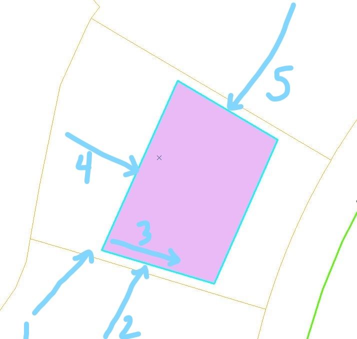

Thank you for your response - not sure why my images are blurry as they are not so on my side when I review the response.  Regardless, the next step does not do a parallel trace, rather I turn on snapping for vertex and edge first.  In the image, you'll see numbers and arrows.
1.  With the reshape tool selected, snap to a corner marked 1.
2.  Move your mouse along the edge marked 2 and right click.  Select parallel from the context menu.
3.  Right-click again where you did in item 2 and select Length from the context menu.  Type in 25 ft.
4.  The sketch is constrained 25' - click to place a vertex on the line where the 3 (and arrow) is located.
5.  Right click again on the item marked 4 and select parallel from the context menu.
6.  Move your mouse to the item marked 5 and click once to place a vertex.
7.  Click F2 on your keyboard to finish the sketch.  The area to the left of the polygon will delete.
This should work for the first edge constrained 25'.  Then repeat the process for the back line.  Hope this helps!Trace5.JPG
