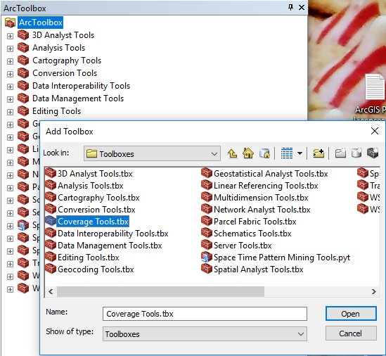

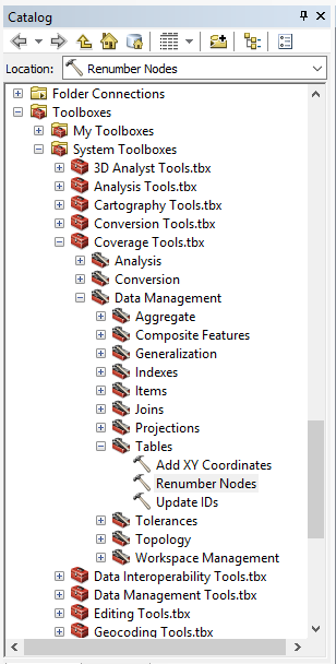

The Renumber Nodes tool is available via ArcCatalog or ArcMap. If accessed via ArcMap you need to open the Catalog tab and open the System Toolboxes folder. In pre-ArcGIS Desktop 10.4.1 installs this toolbox was available from ArcToolbox but at 10.5.1 it is not (you can add it to the ArcToolbox as well by navigating to the toolbox at c:\program files (x86)\ArcGIS\Desktop10.5\ArcToolbox\Toolboxes).
See image below
