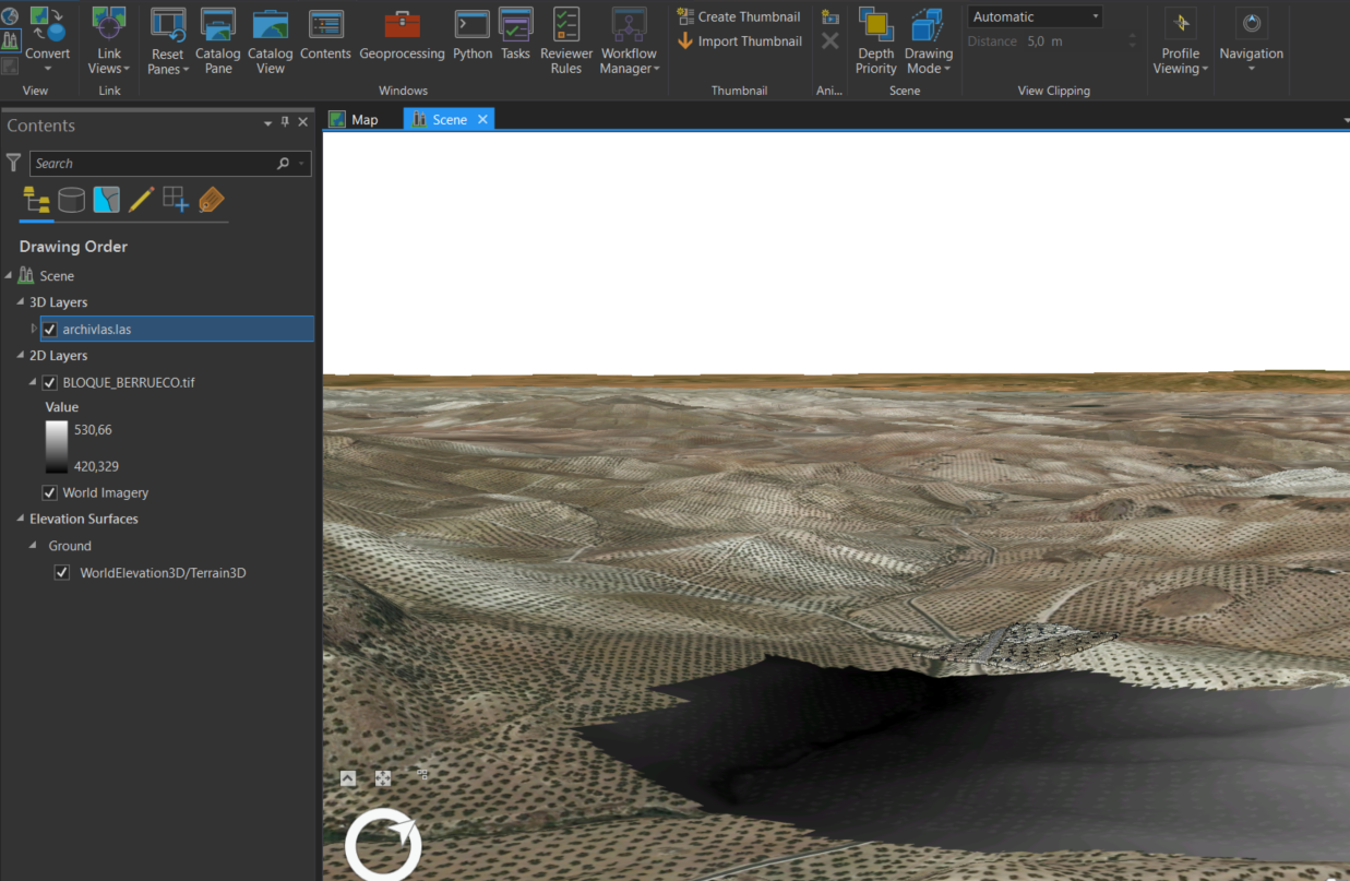

Hi, Im new using ArcGis Pro, I want to know how can I move my LAS dataset to the ground.
I have the dem (grey scale) Its correct georeferenced but the LAS dataset is above of it. How can I move the lidar points to the ground?.
JonahLay
Hi Dario,
Right click on your point cloud layer in your Contents pane and click Properties. In the Layer Properties dialog box, click on the Elevation tab. You can change the Cartographic offset. It may take several attempts before you are able to define a value that matches your desired result.
