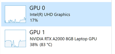

I am trying to load a large multipatch into ArcGIS Pro.  It was converted from a dwg that represents a ground surface with approx 230k faces.  ArcGIS Pro will not draw the entire thing and shows an error about GPU resources exceeded, however looking at task manager this does not appear to be the case.  Can someone from Esri please explain how this is calculated, and what we can do about it?
This confirms it is using the dedicated AMD graphics not the Intel chip:

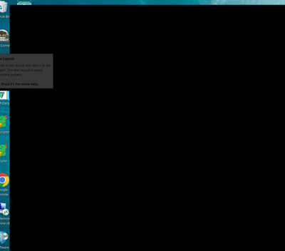

Did you ever figure this out?  I was drawing time cubes fine a few weeks ago.  Got a new machine and I cannot get Pro to use much of my GPU.  I cannot even get anything to draw on the screen now.  Tried two different computers and every setting and driver I can think of.   i9, 64 GB or RAM, 32 GB video ram should be plenty.  Second machine has a NVDA 5000 in it with 64 ram and 32 video ram also.
I does not seem to be culling at all.  No matter where I zoom to it will start drawing the bottom left corner of the extent.
Not sure what changed on me.  I did a few cool demos, people got excited, and now I am stuck.
And now it went black on me.
thanks a lot
