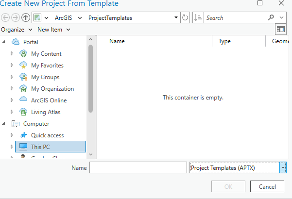

I'm a new GIS user and I'm trying to do some tutorials I found online. I'm currently trying to start this one:
https://learn.arcgis.com/en/projects/model-coastal-inundation-impact/

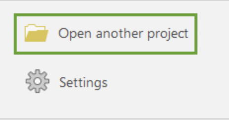

However, whenever I download the .zip file as the article instructs, I can't open it in ArcGIS. As the tutorial instructs, I download it, and then open it through the "open a new project".
When I click it, it gives me this:

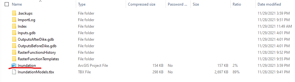

Even though when I go through my files, it is clearly displayed:

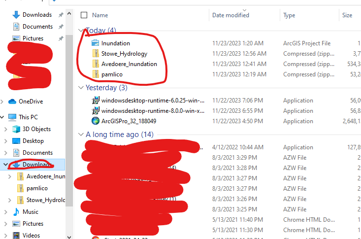

I also tried just straight up going through the files and clicking on the project file, but none of the other data in the folder carried over. I just clicked on the "Inundation" file:
When I did so, all the data in the Inputs.gdb, etc. were all gone, which makes sense, but I still don't know how to open it in GIS.

Make sure that you have extracted the contents of the Avedoere_Inundation.zip file to a folder on disk by right clicking on the zip file in Downloads --> click Extract All --> extract to a folder on your hard disk. Then open the Project file from the extraction location.
Note also in the documentation that the tutorial requires the following:
  • ArcGIS Pro Advanced
  • ArcGIS Spatial Analyst extension
