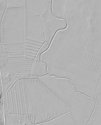

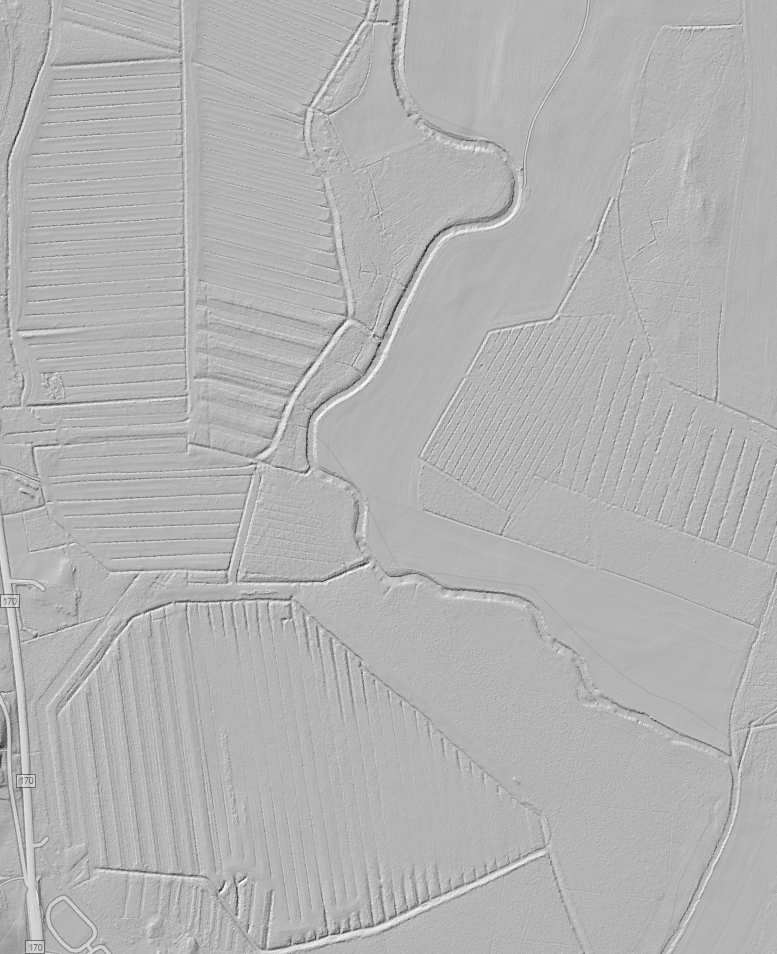

Hi, I was hoping someone could give me some advice. I'm trying to use deep learning to detect drained peatlands and marsh trenches. The input raster is a hillshade of dtm.
The first problem is my training data. Upon inspecting the tiles many of them was not on any trenches. Any tip on how to train on larger structures?
The second problem is that the output detected objects are mainly single lines (like roads) and not on trenches which looks like this:
