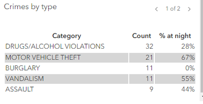

Good question, so the table from the above expression looks like this:

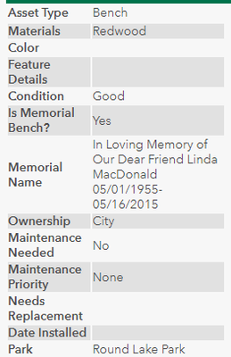

It creates variables that count instances of a different field (crime type). I really only need to show the actual attribute values present in a layer, at least at this point. A popup that I would like to re-create using a similar expression but is right now built with HTML is:
So just "Attribute Name"       {Attribute Value}
Below is the HTML I current use to make that popup above.

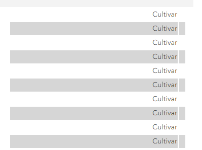

I could definitely be overthinking this, but I tried to adapt the expression just to test it out with one of my own layers (this is a different layer than shown above, but you get the idea I think):
// Build an HTML table to display the summary of
// crimes by count and how many occurred at night
var cssGray = "style='background-color:#d6d6d6;'";
var cssRight = "style='text-align: right;'";
var cssCenter = "style='text-align: center;'";
var table = "<table style='width: 350px'>";
var i = 0;
for(var item in $feature){
  table += `<tr ${IIF( i % 2 != 0, cssGray, null )}>
    <td ${cssRight}>Cultivar</td>
    <td ${cssRight}>${$feature.Cultivar}</td>
  </tr>`;
  i++;
table += "</table>";
// Return the table as a text element
return {
  type: "text",
  text: table
And I get this:

A couple of things. Your code is looping through at the fields of the feature, but you're returning only the one attribute for Cultivar for each field. Also, you're arbitrarily setting the size of the table to 350 px, which is larger than the popup width. Use width=100%, which will make the table as big as the longest value and attribute. Try this instead (and please use the syntax button when adding code)
