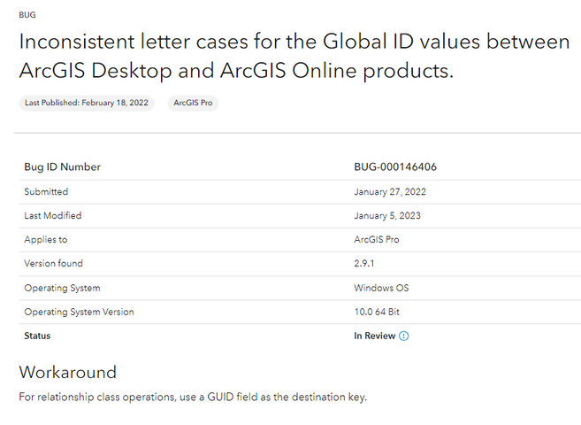

Did some digging and it is now been moved to a bug  BUG-000146406.   So some progress at 4 years.  If anyone can escalate please do.
https://support.esri.com/en-us/bug/inconsistent-letter-cases-for-the-global-id-values-betw-bug-00014...
It is not just Pro of course though
BUG
Inconsistent letter cases for the Global ID values between ArcGIS Desktop and ArcGIS Online products.
Last Published: February 18, 2022
ArcGIS Pro
Bug ID Number BUG-000146406
SubmittedJanuary 27, 2022
Last ModifiedJanuary 5, 2023
Applies toArcGIS Pro
Version found2.9.1
Operating SystemWindows OS
Operating System Version10.0 64 Bit
StatusIn Review
Workaround
For relationship class operations, use a GUID field as the destination key.
Bug ID: BUG-000146406
