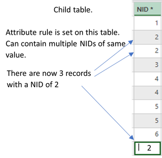

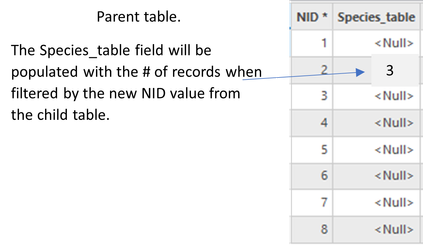

I am trying to create an attribute rule that populates a field in an origin table when a field in a child table is updated. This could be from adding a new record, or updating an existing record. Both tables have a field named "NID", which is being used as the relationships primary and foreign keys. The NID field in the parent table has unique values and the NID field in the child table can have multiple of the same value, so the relationship is many to 1.

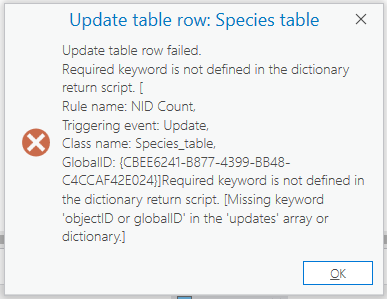

The problem I am running into is when I try and return the results. I have looked at examples and read the Esri documentation, but still find if very confusing. I keep getting an error about Global IDs and not sure why. Both of the tables have GobalIDs, but they are not being used as key fields so I don't understand the error.
