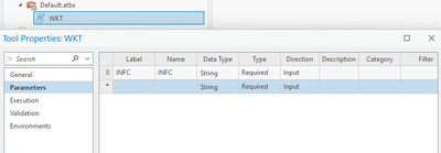

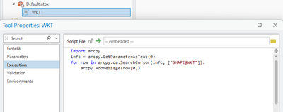

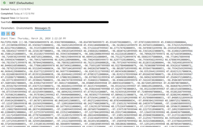

@McKenzieBredemeyer If you can add script tool to a toolbox, this is about as simple as you can make it.  Add one parameter for your input feature. Add this script to the tool and save, To run select a polygon, add the feature layer as the input.  It outputs the WKT in the Messages window.
import arcpy
infc = arcpy.GetParameterAsText(0)
for row in arcpy.da.SearchCursor(infc, ["SHAPE@WKT"]):
    arcpy.AddMessage(row[0])
import arcpy

Thank you so much, this is so helpful.
