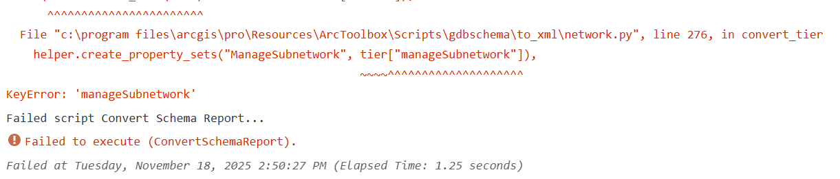

I am using ArcGIS Pro v3.3.6 and I'm trying to get the schema of an .SDE geodatabase (SQL Server) containing a Utility Network (and other feature classes/tables) to a File Geodatabase.  I've tried running the 'Export to XML Workspace' and the export works fine, but every time I try to import it throws an error.
I've even tried 'Generate Schema Report' as a JSON, then converting to an XML for import, but that also fails.
Has anyone else experienced this?  Is there a workaround?

Thanks for the reply.  Yes, I have.  The screenshot in the post is the error thrown by the 'Convert Schema Report' tool.  Generate Schema Report only gives me a flat file, I need a file geodatabase.
