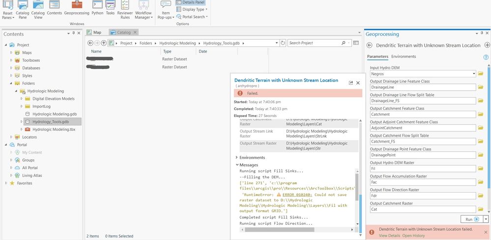

Hi, I really need some help 'coz I'm a beginner in ArcGIS Pro 😞 how could I possibly solve this?Screenshot (40)_LI.jpgScreenshot (41)_LI.jpg
JayantaPoddar
MVP Alum
The path of the datasets (input as well as output) doesn't look correct.
In case the Raster is pointing to a basic file folder, it should have an extension (e.g. D:\Hydrologic_Modeling\Negros.tif).
In case the Raster is pointing to a Geodatabase Raster dataset, its parent directory should be a Geodatabase (e.g. D:\Hydrologic_Modeling\Data.gdb\Negros).
Use the browse button to ensure you are navigating to the file path correctly.
*Please use short file pathname, without the use of space or special characters (except underscore).
