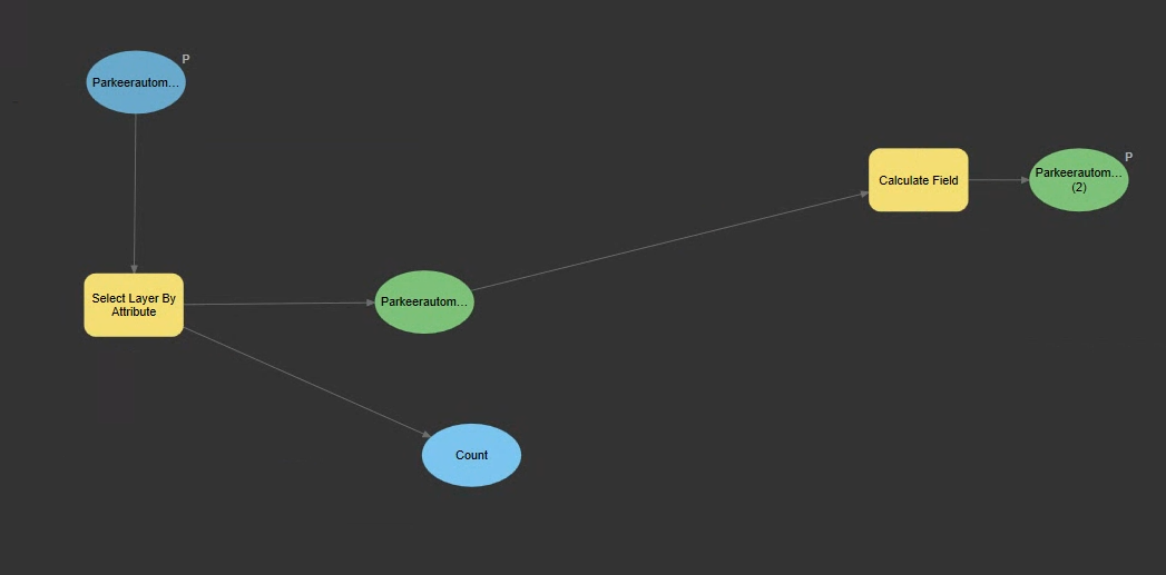

I have an error with scheduling a ModelBuilder calculation on a online feature layer. The online feature layer receive data every 5 minutes from field workers outside. First I add the online feature layer in ArcGIS Pro and made the following ModelBuilder:
Kantoor__DataCount__Verkeerso_1-1657717579834.pngKantoor__DataCount__Verkeerso_1-1657717579834.png

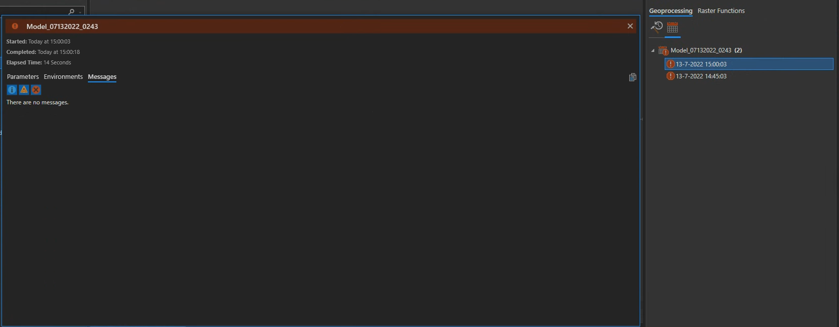

First I make a selection on a specific value in a certain column. The selection will be recalculate with an expression I made which runs perfect! Only thing that matters is the tool only works if I run it directly. When I try to schedule the Model every 15 minutes it gives the following error:
Kantoor__DataCount__Verkeerso_2-1657717840332.pngKantoor__DataCount__Verkeerso_2-1657717840332.png

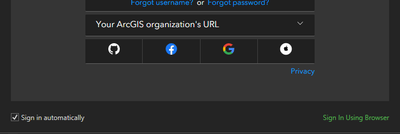

Kantoor__DataCount_-_Verkeerso
Hi,
Yes, I followed the instructions as mentioned in the video you'd sent. I'm also signed in automatically, so that unfortunatly doesn't cover the issue.
Kantoor__DataCount__Verkeerso_0-1657722850828.pngKantoor__DataCount__Verkeerso_0-1657722850828.png
