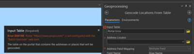

Geocode Addresses works for our organization, but I will chime in and confirm the same behavior with 'Geocode Locations From Table'. As far as I can tell, the tool is having issues reading local tables, possibly due to a formatting of the path name.

I updated to 3.4.3, and while I'm still having this issue with the Geocode Table button, now when I click on the Geocode Table button, there's a "Go to Tool" button in the window that appears that I don't believe was there before (??). If I click that, it looks like the Geocode Addresses tool window, but after geocoding, I have been prompted to start rematching tied/unmatched points. So that works I guess?
