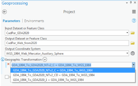

Environment : ArcGIS Pro 2.1
If our data is in GDA2020 and we transform to Web Mercator, the software first does a datum transformation to GDA94, and then to Web Mercator.  The Geographic Transformation is chosen for me, and I cannot alter it, nor can I delete it – as shown below.
Project Geographic Transform
This is what is occurring:
  • GDA_1994_To_GDA2020_1
    • A datum transformation to GDA94
  • GDA_1994_To_WGS_1984
    • NULL datum transformation to WGS84
Effectively– this is not the GDA2020 realization of web Mercator - It transformed to GDA94 first.  It is the GDA94 realization of Web Mercator.
Are other people aware of this?
Implications?
Cheers,
Mark

I followed up the issue with Esri.  They have confirmed the behavior described, and are looking toward a solution.
It is not so straight forward.  The EPSG codes were not available so a work around was done.  This would appear to have been an oversight of the ICSM and thus affects all software vendors.
Right now there is not a datum definition that goes between GDA2020 and WGS84 web Mercator. It is being ratified by EPSG / ICSM. As a work around the way Esri have implemented the migration to WGS84 Web Mercator is to project back to GDA94 first.
Esri are working to provide a GDA2020 to WGS84 Web Mercator but until this is in place by the international bodies then Esri cannot implement a full datum transformation. Until this time the solution is to go through GDA94 first.
Users implementation plans for proving web services based on the GDA2020 realization of web Mercator may well be affected by this.
Cheers,
Mark
