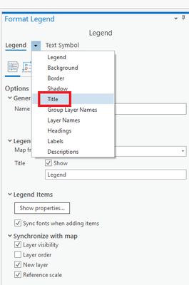

In Pro (currently using 2.6), is there a way to adjust only the font of the legend title (usually "Legend")? You can change the text symbol for everything within the legend, and usually the word "Legend" is a different size from the rest of the contents, but I cannot find a way to change just the title. Any ideas? Evidently, you also can't selectively alter any of the other legend items (Group layer name, Layer name, Headings, Label (or layer name), Descriptions)

Yes you can change the font of the legend title. Edit the properties of the legend so you are on the panel below, then from the drop-down arrow select Title, from here you can change the font/size/colour etc.

Thanks! Can't believe I missed that arrow
