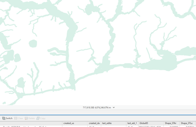

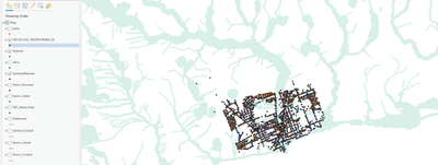

@DanPatterson @ThomasHamill So I was able to find the water dataset.
Using the water dataset . I am trying to determine which assets I would need to replace.

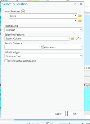

@CanJM, I recommend the following for a simple approach:
1) add a new field (integer or short field type) to Poles--in fact, add one for every variable/factor you want to populate upon Poles.  You could name them something like "RiskScore_FromManhole," "RiskScore_FromPond," etc.
2) Run a select by location  to find the subset of Poles that either intersects or is within a distance (that you find reasonable/meaningful) of each of your factor layers.  Add a value of 1 in the Pole field for the respective risk scores--any Pole that doesn't touch a factor (or its distance buffer) should be given a value of 0 for that "RiskScore_FactorLayer" field.
3) After you've populated each factor-based risk score field in the Poles attribute table, add a new field called something like "RiskScore_Total" and set that equal to the sum of each of the individual factor risk scores.  The higher the value, the more at risk (in theory) the pole is based on the combination of the factors/variables it intersects or is near.

@ThomasHamill  Hello, I have tried the method. I added risk from Storm Culvert field to poles.  When I clicked apply it highlighted every pole. Nothing else happened. I followed it. When I tried  different selecting feature such as manhole. It selected all poles. That's all it did. Please help me. Thank YOu
