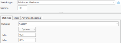

You can use a Minimum Maximum stretch and set custom min & max values.

Thank you very much, Luke
Simple, easy and effective solution
