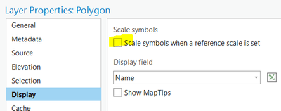

It appears your map has a reference scale set. Setting a reference scale in a map means that symbols and labels maintain a constant measurable size. For labels, that means the text will draw at the specified size (8pt in your case) only when the map scale matches the reference scale. It will get smaller as you zoom out and larger as you zoom in.
If your map needs to use the reference scale, individual layers can ignore the reference scale by unchecking Scale symbols when a reference scale is set box in the layer's display properties.

Thanks for reminding that!
