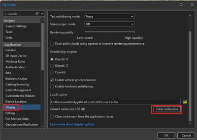

On top of the resolutions Dan pointed out, you could clear your cache as well.
Project --> Options --> Display --> Clear Cache now
