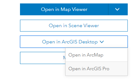

"Open in ArcGIS Pro" menu item does not open ArcGIS Pro
It downloads pitemx file. If you click on it Windows doesn't know wat to do with it

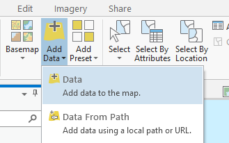

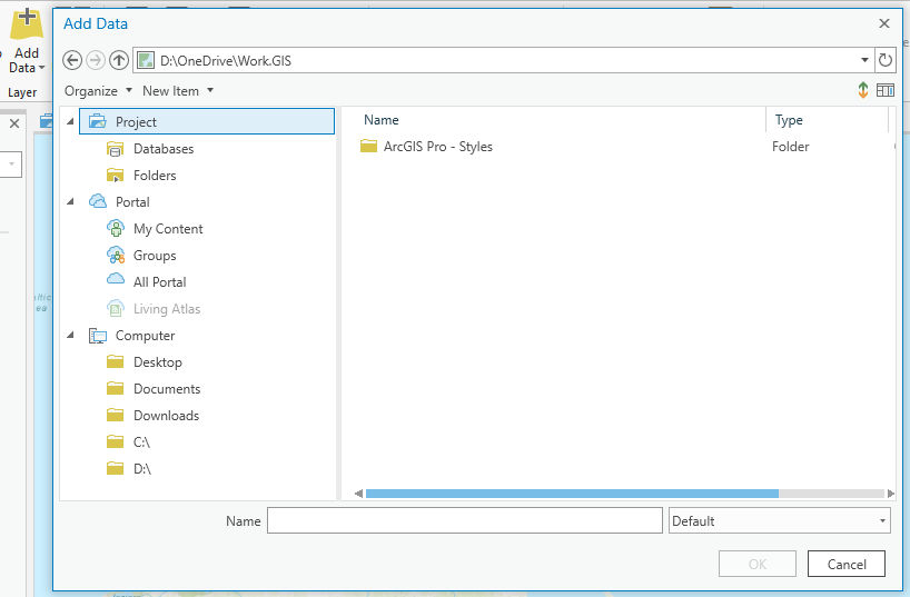

ArcGIS Pro option to Map -> Add Data does not allow to add pitemx

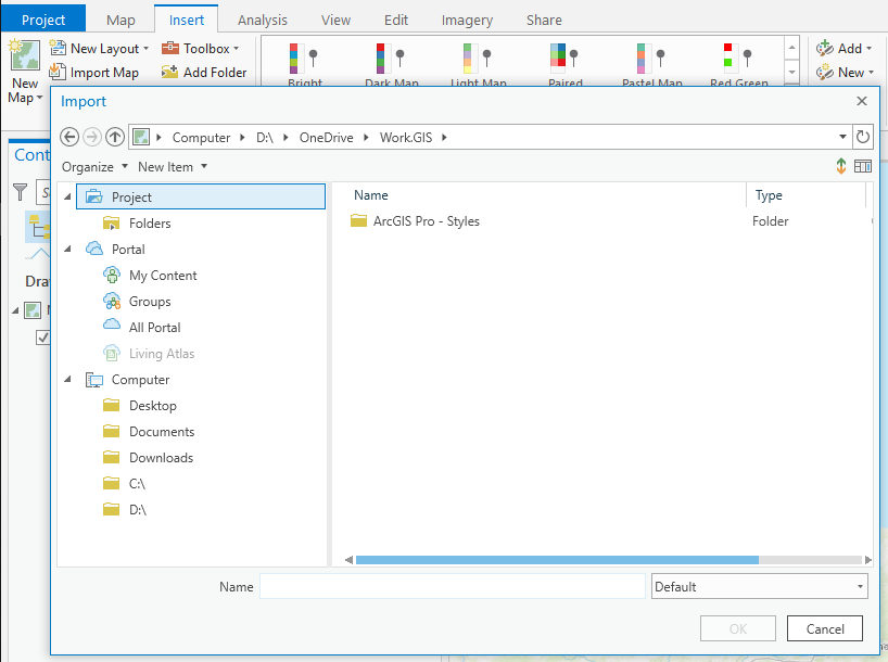

ArcGIS Pro option to Insert -> Import Map does not allow to add pitemx

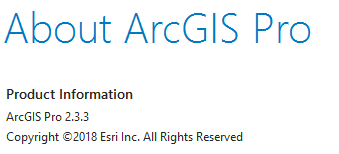

Can you confirm that you're using ArcGIS Pro 2.3?
KubaSzostak1
ArcGIS Pro 2.3.3 installed (issue with license borrowing is resolved).

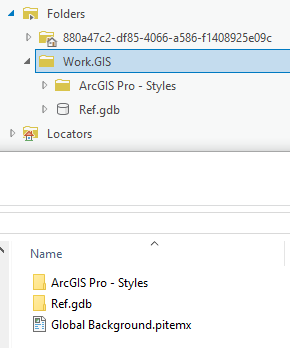

ArcGIS Online and Portal still doesn't open Pro, they download item.pkinfo file. Clicking that downloaded file opens ArcMap (10.6.0).  PITEMX files located at local machine are not visible to Pro at all:
But workaround to use pitemx files directly from ArcGIS Online suggested by @Liz Cruz does work.
