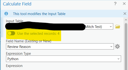

I was calculating some rows on a hosted feature service in ArcGIS Pro 3.2 and noticed something weird.  I made a Selection Layer by selecting 100 rows from the hosted feature service attribute table, right-clicked the layer in the Contents Pane and clicked 'Make Layer from Selected Features'.  From there I opened the attribute table of the selection layer, selected some rows, right-clicked a field and opened 'Field Calculate', disabled the 'Use the selected records:' slider, and ran the tool.  The tool then calculates the value for that field for the ENTIRE hosted feature service layer, and doesn't honor the Selection Layer found in the map.
Has anyone else had this issue?  Is this the intended functionality?

I was able to reproduce that behavior with a selection layer on a file geodatabase FC in ArcGIS Pro 3.2.2.
I wonder if the selection layer's selection definition set is considered to be an attribute filter. When the Use the selected records toggle is disabled, the GP tool will ignore all attribute filters (definition query,  time filter, range filter).

Thanks for the reply, Bud.  Since this layer is a different layer in the map (yes, they are "pointing" to the same data) my opinion is this behavior shouldn't happen.  This makes working with subsets of data extremely difficult and confusing. If I wanted to work with the non-selection dataset, I would use the drop-down in the Calculate Field tool to do so, but that is not my intention.
