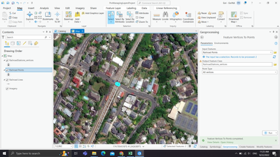

Hala_Ghareeb
Yes, you can apply the tool for only the selected features. Just select the desired feature, then run the tool. In the tool panel you will find that there is a message in blue about how many features are selected as in the image below 👇

Hala_Ghareeb
@DavidMrázek
I think the tool takes the whole layer because you are using the feature Class not the layer from the map contents.
so try to follow these steps:
1- select the desired features.
2- make sure from the table of the layer that you have a set of selections
3- open the tool pane
4- drag the layer from the contents to the input features box in the tool pane.
5- add output name and run.
