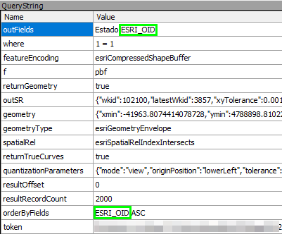

Using Fiddler, I can see the requests that ArcGIS Pro is launching:
The ArcGIS Pro requests are using the ESRI_OID field, a field that has no real existence in the database, and the operation causes this in the server log:
The ESRI_OID field is shown as one of the available fields in the service definition (according to the REST API documentation):
If I try to manually launch the same request removing the ESRI_OID field references, the service gives the expected response. So it looks like the service is working (kind of...), but ArcGIS Pro is not composing the right requests...
