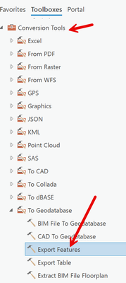

The answer depends upon the version of Pro you're using. If you're using a newer version you can look for the "export features" tool.

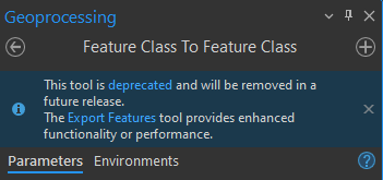

I use 3.1.1 and the "feature class to feature class" tool is still available but it's accompanied by the following pop-up:
Hope that helps.

new tool, new location
... sort of retired...
