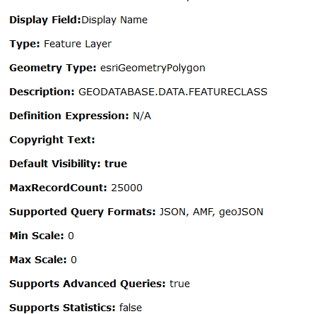

Recently I have published a map service in ArcGIS Enterprise 10.7 from ArcGIS Pro 2.4. This service contains layers with a join between a feature class and a table.
When I published my service I filled each layer's metadata individually using ArcGIS Pro Layer Properties but when I published my services the Layer's Description shows the Feature Class Database Name (for the record, the data is referenced from an Enterprise Geodatabase in SQL Server).
Is there any issue (bug) concerning layer description or am I filling the wrong field in Pro? I don't want to edit manually the layer properties using REST admin.
Here's an example screenshot.

How would you edit the layer properties with the REST admin?  As far as I can tell you can only edit the Service information and not the properties of the individual Feature Layers.

Ths issue seems to be fixed with ArcGIS Pro 2.5.
